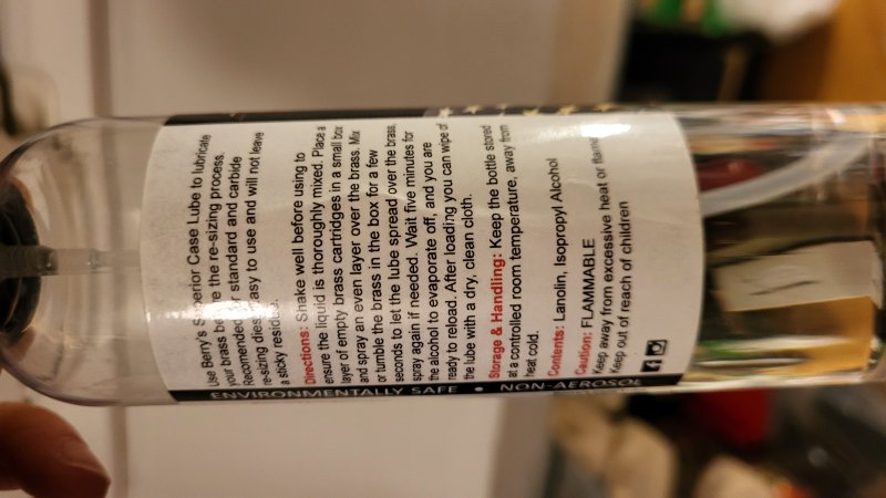

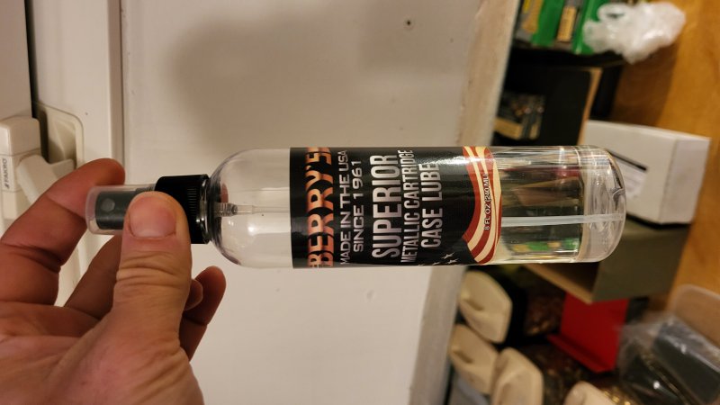

Dnes 22:03:29
Re: Pistolníci
http://www.suzukibandit.cz/openforum/uploads/760_20251215_183016.jpg
http://www.suzukibandit.cz/openforum/uploads/760_20251215_183022.jpg
I to original mazani neni nic jineho nez to co ve videu.
